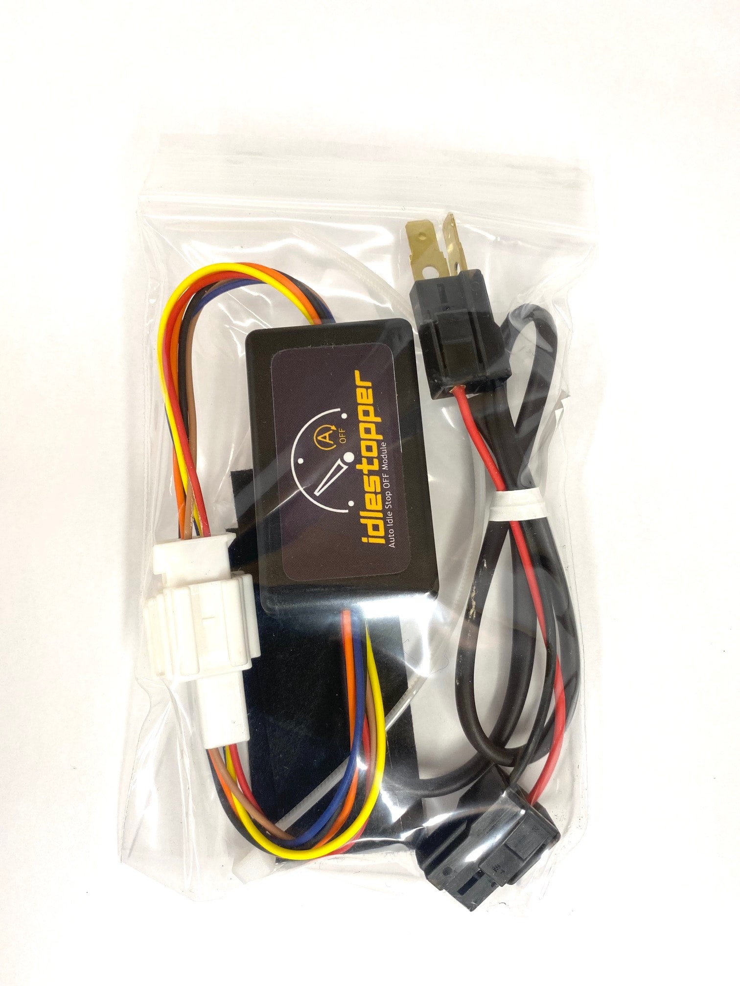

I have the idle stopper installed as well as the VCM Tuner II and I was at my dealer last week to get the battery replaced. They didn't bat an eye or say anything about the mods I installed. They also did the auto stop TSB while I was there. So you have nothing to worry about.
What idle stopper are you using?

The product you mentioned / propose above SEEMS like a good one because it resolves the faulty stop start system making the car safer. My (tough?) questions:
1) is it legal to install in my car
2) would it interfere w any additional updates by honda on the start stop system
3) if I sell my car and the dealer asks, “was this car modified”, would the answer be yes or no for above product?
4) If I’m not handy, who is qualified, what type of business, to install this?
Thanks..

1) Why would it be illegal? It's your car so you can do what you want. The idlestop device is just going to "push the button" for you.
2) Nope. I had it installed when I went to get my battery swapped and they did the TSB for the autostop
3) Dealer has no reason to ask you if you modified the car.
4) Dealer won't do this but an indie shop may. It's actually pretty easy to do. Hardest part for me was getting the console cover off.
What Karl said and here is the video on how to do it. Super simple.
Sent from my iPhone using Tapatalk
