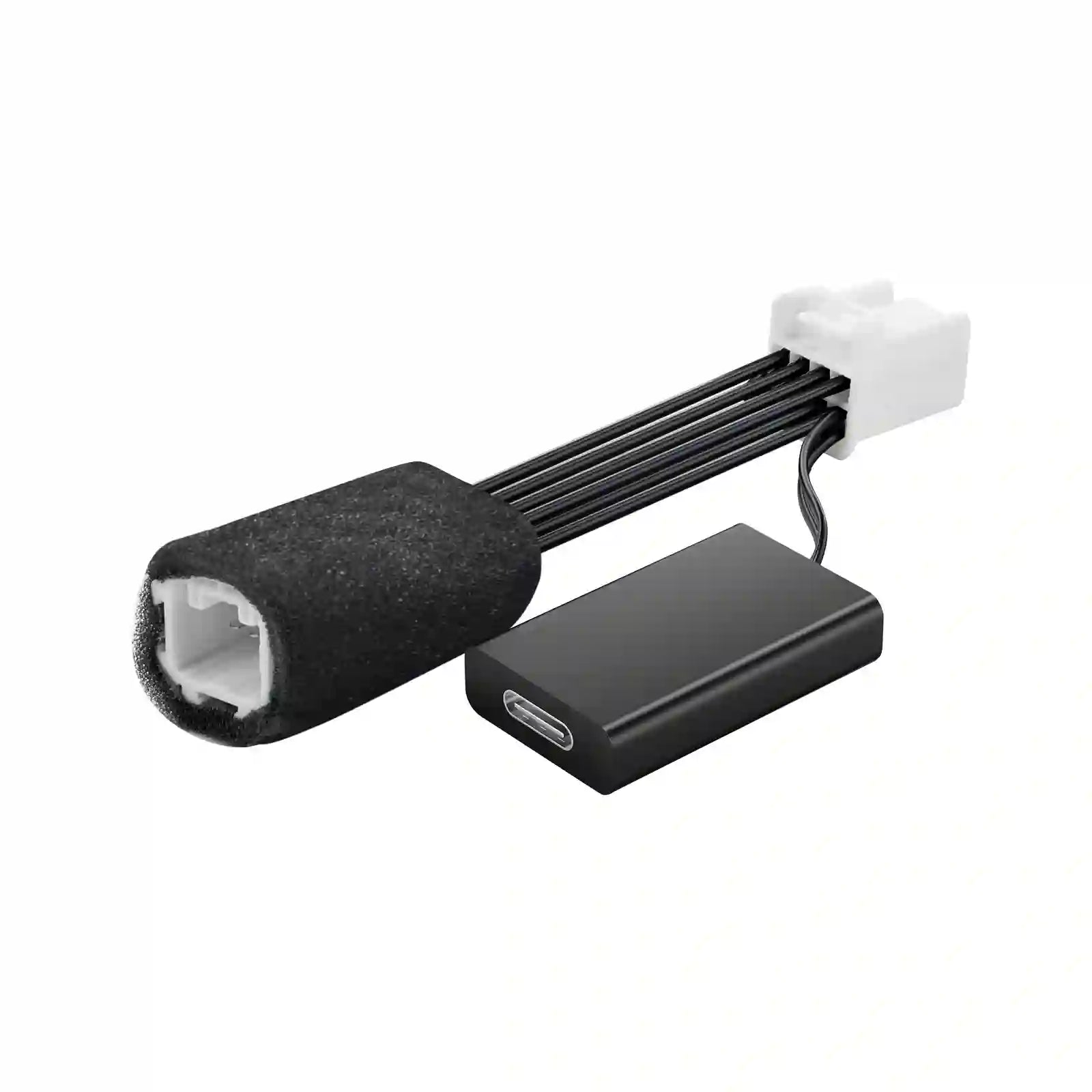

Does anyone have experience with an adapter to put in the overhead console above the mirror to connect a dash cam or just add a USB-C port?
Looking for one for a 2025 Pilot EX-L to avoid dangling wire or running around dashboard.
The Dongar 7-pin is not the right part, you need to use the universal adapter with an adapter to usb-c. I believe the Pilot connector is a 6-pin which Dongar doesn’t make yet, at least one which will work with the Pilot.
I did this exact installation about 2 months ago, using their universal with micro usb termination and then used an adapter to change the end to a usb-c to fit my Garmin cam. It works great and really makes for a clean looking installation.

Has anyone tried this:
The plug 'should' work on dome light connection behind the sun-glass holder. The plug looks the same, was hoping someone else has tried.
#37 ·
That's the plug that I want to try in my '25 Pilot.
