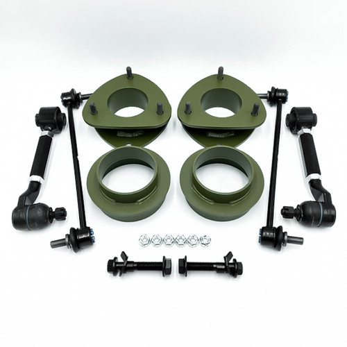

Got the lift installed yesterday! Well it's technically a leveling kit. Made by ReadyLift, it is currently the only product on the market for the pilot. You can find it on eBay for 699, but the local truck lift company sold it to me for 575...610 with tax. The install was 300.
I ended up doing it myself since my dad owns a garage....he helped. I would not recommend doing this yourself! Save yourself the trouble and have a lift company do the work. Instructions were horrible!
After the install, I took it to Goodyear to have the alignment and new tires put on. Kept the oem rims since they look nice and this was an expensive enough endeavor!

I know this thread is old, but HRG has a 2" kit that has significantly dropped in price, $319 with the camber bolts, $275 without.
I decided to purchase the HRG instead of the ReadyLift. I can’t wait to receive it and install it!

The lift kits for the Pilot consist of 1-3” metal spacer blocks that bolt onto the upper front strut housings and spacers for the top of the rear springs. Generally this is the best time to replace worn suspension parts. The alignment tech may recommend camber bolts, adjustable rear CA to complete the alignment.

The subframe drop kit is designed to reduce the CV axle angles after installing a lift kit getting them closer to stock for best results. The subframe drop kit actually makes installing the lift kit easier.
