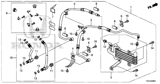

Gotta get a little creative when adding a BATC to the 9 speed tranny. I would think cutting the rubber tube section of ATF Hose A and ATF Hose B and simply clamping in two straight 3/8" hose barb fittings would allow for the installation of an aftermarket BATC with hose barb nipples. A little more creativity will be required to hang/mount the BATC itself.

In stock form there are no rubber hoses in the atf cooler circuits. Only two stainless pipes with a multi o ring fittings, retained by a bolt in finger. Atf hoses are added as part of the kit.
AWD Ridgelines come with a cooler that uses rubber hoses.

Yep, in the diagram it appears there are sections of rubber hose in ATF Hoses A&B......not the case in the ATF Pipes A&B.
This is the best solution.

Yes Ridglines come with the accessory cooler as standard equipment. The op has a pilot, and was asking about a Pilot. On a PILOT there are no rubber lines, the rubber lines are added and come with the accessory cooler.
I can't confirm there are rubber hose sections but it looks that way and if so, you only have to cut the rubber portion of ATF Hoses A & B (not Pipes A & B) and insert/splice in the hose barb fitting. The link says 2018 Pilot 9 speed. The later part of ATF Hoses A & B would not be used (discarded). The rubber hose that comes with the aftermarket cooler would be used in place of the discarded hoses in the Honda kit.
