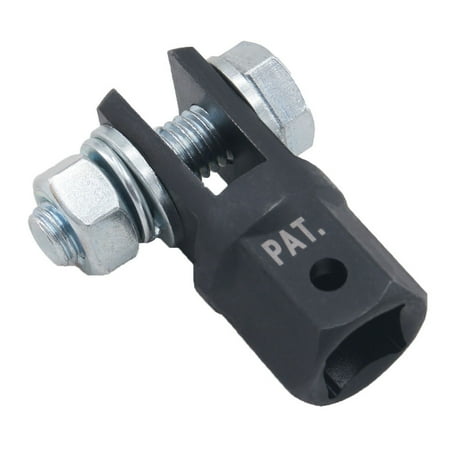

Saw this scissor jack adapter and thought, since I don't have a floor jack or a bottle jack, that this might make lifting each corner twice a year to change out winter tires less tedious. It's supposed to let you use your impact drill with the OEM scissor jack.
Sure, there are more professional solutions, but is there any reason you think this wouldn't work?

Description
Material: Chrome Vanadium Steel(50BV30 Steel)
Exterior: Black oxide finish
Item Weight: 135 g(4.86 ounces)
Product Dimensions: 50.7*41.4*24 mm (2.0 x 1.63 x 0.95 inches)
Slot Size: 8.8 mm(0.35 inch) wide, 23.90 mm (0.94 inch) deep
Bolt Length: 4.1 cm (1.6 inches)
Bolt Dimensions: 0.97 mm
(Enough to fit most of scissor jacks, To ensure this, you can check the oval's size on your jacks)
Lift Your Jack Very Easy:
Made Of Very Solid Chrome Vanadium Steel, Easily use with your scissor jack, Suitable to most loop type or double eyelet type scissor jacks in the market. If you are worried about its compatibility, please check the oval's size on your jacks.
1/2" Drive/impact drills/ratchet or standard drive sockets
13/16" Lug wrench/tire iron or socket or easily add a half inch adapter to any drill
If you don't have a 1/2 inch hex or impact wrench, you can very easily get a standard drill bit to 1/2" adapter and use any cordless or corded drill with this tool and those difficult scissor jacks.
Packing List:
1PC * Wrench Tool

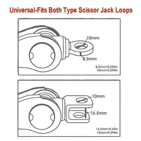

Owner's Manual illustration of the "loop" type end connection of the OEM jack...
143801
