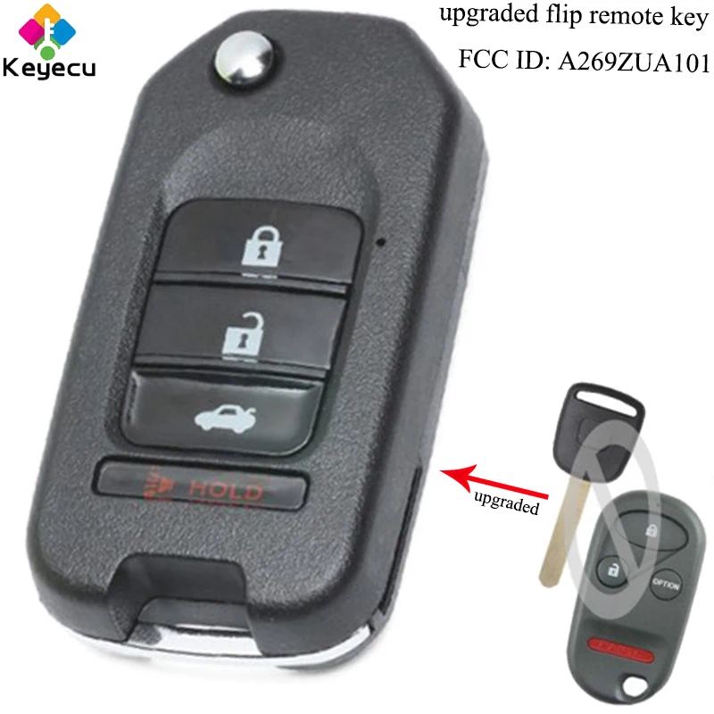

      Or even treat yourself to an upgrade to an all-in-one flipkey. I did and would never go back to the stabber key regularly causing unseemly pain while in my pocket. :eek:
      20.15US $ 12% OFF|KEYECU Upgraded Flip Remote Key With 3 1 4 Buttons 433MHz T5 Chip FOB for Honda Odyssey Pilot 2003 2004 2005 FCC ID: A269ZUA101|Car Key| - AliExpress
