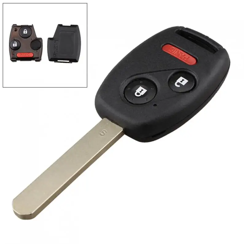

      I'm looking for just the key with the RFID holder, no build in FOB. So I think I need to order this:
      1.17US $ 15% OFF|KEYYOU New Uncut Replace remote car key Transponder Ignition for honda CR V XR V Accord Civic Jade No Chip|Car Key| - AliExpress
      ... and then use they their key cutting service.
      Now I'm trying to puzzle out which RFID chip I need to purchase. From this website:
      https://www.transpondery.com/transponder_catalog/honda_transponder_catalog.html it looks like I have:
      HONDA PILOT - 2003-2005 Transponder Megamos13 / ID13 / Silca: 13 / JMA: TP05
      So I'm looking for RFID chip with ID13, correct?

      For the immobilizer chip, either dig them out of the original keys and secure them in your new keys, or buy new immobilizer chips and a little immobilizer programmer, or pay the dealership to do it, which will likely cost you more.
      It's the immobilizer chip.
      My AliExpress key worked just fine because I transferred the little immobilizer chip from my previous key.
      Was your new key without a chip, as most are? Or did it specify it came "with chip" as this one does?
      US $11.95 33% OFF|1pcs 433MHz 3 Buttons Keyless Entry Remote Key Fob Clicker with 46 Chip CWTWB1U545 fit for Honda Pilot 2005 2006 2007 2008|Car Key| - AliExpress
      Since you don't have a previous key to transfer the immobilizer chip, in either case you'll need to get it programmed, either by the dealer or with a little chip programming tool.
      If your new key didn't specify that it comes "with chip," you can one here, for example:
      US $4.19 33% OFF|Blank T5 ID20 Carbon Chip Car Key Transponder Chip Replacement fit for VW AUDI HONDA|Car Key| - AliExpress
      Next, program the chip either at the dealer ($) or get one of the blue Honda immobilizer chip programmers from AliExpress or eBay or wherever. Be sure it says "For Honda" and to buy from a seller you think you can trust.
      honda easy key maker – Buy honda easy key maker with free shipping on AliExpress version
      Once you have programmed the chip, install in that little space for it near the hilt of the key. Secure it there. I used blue sticky tack, like for putting up posters, but others have used glue.

      No chip, I dug mine out of my old key and transferred it in, along with the fob.
      You can get a chip yourself here, if you need to. You already have the programmer, right?
      US $4.0 31% OFF|Blank T5 ID20 Carbon Chip Car Key Transponder Chip Replacement fit for VW AUDI HONDA|Car Key| - AliExpress
      Depending on your needs, you could also get the whole shebang in a straight key and transfer and program the fob and the immobilizer chip.

      You can get a couple of these, which come with the little (unprogrammed) immobilizer chip.
      10.39US $ 30% OFF|1pcs 433MHz 3 Buttons Keyless Entry Remote Key Fob Clicker with 46 Chip CWTWB1U545 fit for Honda Pilot 2005 2006 2007 2008|Car Key| - AliExpress
      9.43US $ 25% OFF|KEYYOU For Honda Pilot 2005 2006 2007 2008 CWTWBIU545 ID46 Chip Remote Car key Fob 433Mhz 3 3+1 Buttons|Car Key| - AliExpress
      Or you can get any of the chipless ones and buy your immobilizer chips separately...
      4.06US $ 30% OFF|Blank T5 ID20 Carbon Chip Car Key Transponder Chip Replacement fit for VW AUDI HONDA|Car Key| - AliExpress
      ...which you could then use to step up into my happy world of flip keys.
