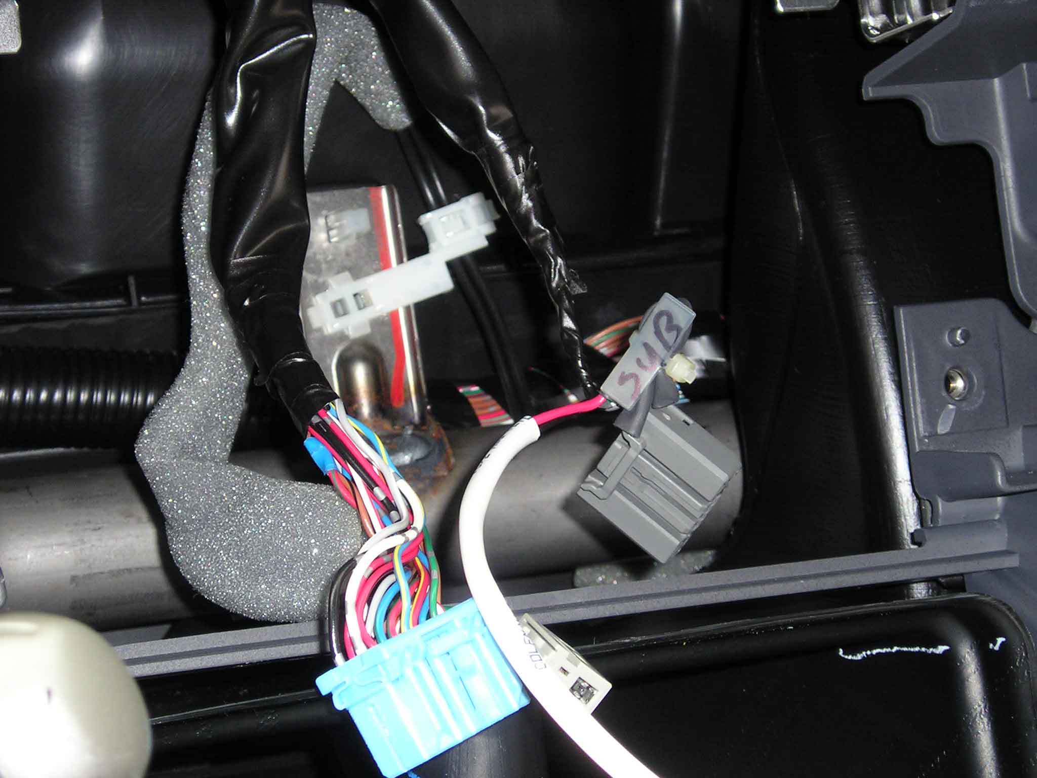

I replaced the factory 6 disk head unit from our 2007 pilot. After replacing it with a sony dvd player and sirius radio I lost the auto up and down on the drivers side window. Could this have anything to do with the stereo replacement? I noticed a two wire plug leading into the factory head unit that I didn't need for the Sony unit. I thought these wires were possibly for the steering wheel controls. I just don't know.
Thanks!!

Thanks, reset the switch and all works great!! Anyone have an idea what the 2 single wires were for the oem head unit? As for that manual, I dug it out of the glove box and placed next to the comode along side the manual for the new DVD player!! Lots of reading to do>

The extra plug might be for the subwoofer.
http://myplace.frontier.com/~zonemin...s/P1010150.jpg
Those two wires are for the steering wheel controls.
