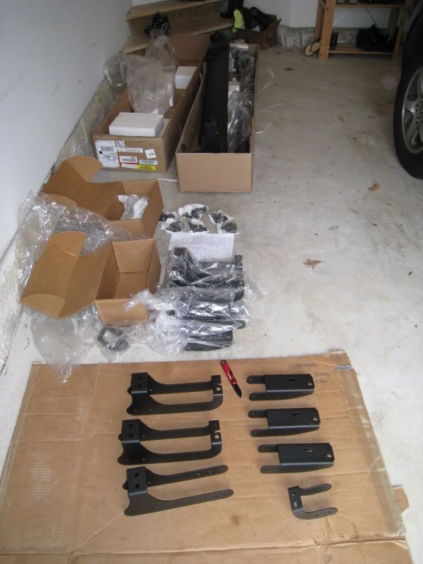

Parts came well packaged and organized:

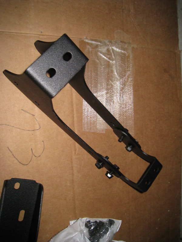

Assemble the front bracket assembly but only loosely, with the bolts and nuts supplied. Front bracket assembly:

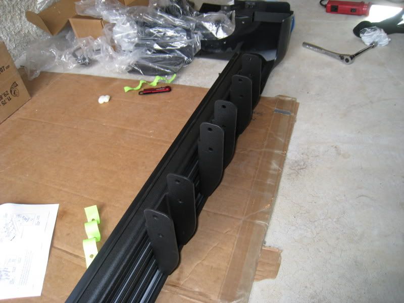

Attach the mounting brackets. Here's a picture of the driver side mounting brackets loosely installed on the frame (attaching everything loosely first allows you to better line everything up later):
Attach brackets to the running boards.
Driver side running board brackets on the board itself ready to be attached to the car:

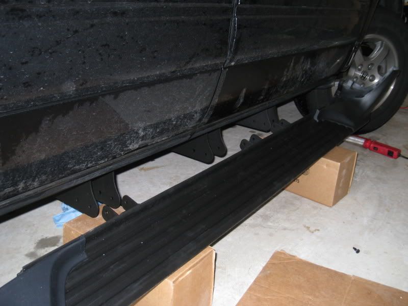

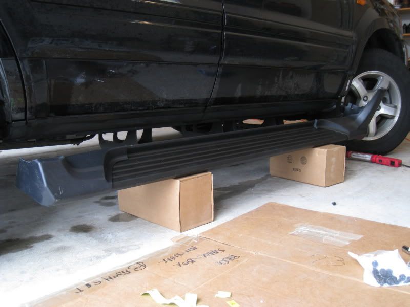

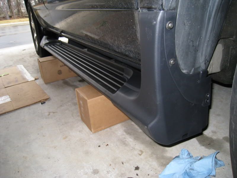

The instructions say to attach the splash guard side first, which is fine, but it is a pain, especially if you're alone, to get fit the piece in while wrestling with the rest of the running board. I just used the two boxes that the brackets and hardware came in to prop the length of the board up to make it easier.
Once the splash guard side is screwed in, you just have to bolt up each bracket to the bracket on the board. Using those boxes to prop up the board made things much easier instead of struggling to hold the thing up, trying to line all the brackets up.

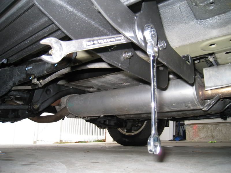

Now you just have to line up all the brackets and bolt them up. Be sure to follow the order listed in the instructions, which is to tighten brackets on the frame first, then the bolts that hold the running board to the brackets. Everything should be torqued to 20 ft lbs.
Another tip - if you have a Gear Wrench or any kind of ratcheting wrench, it makes it much easier to run through all the bolts and tighten everything because it does get tight for a ratchet.

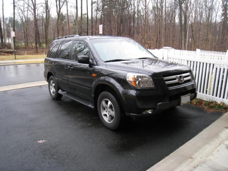

Done:

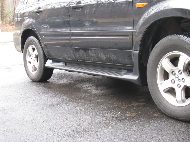

Btw, here's what the car looked like before:
The running boards, to me at least, seem to make a big difference in the way it looks. Looks much more complete now.
